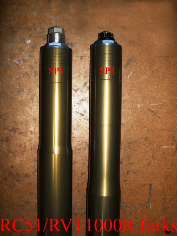

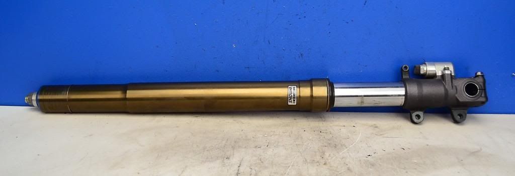

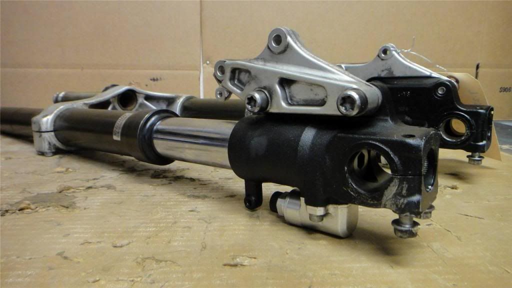

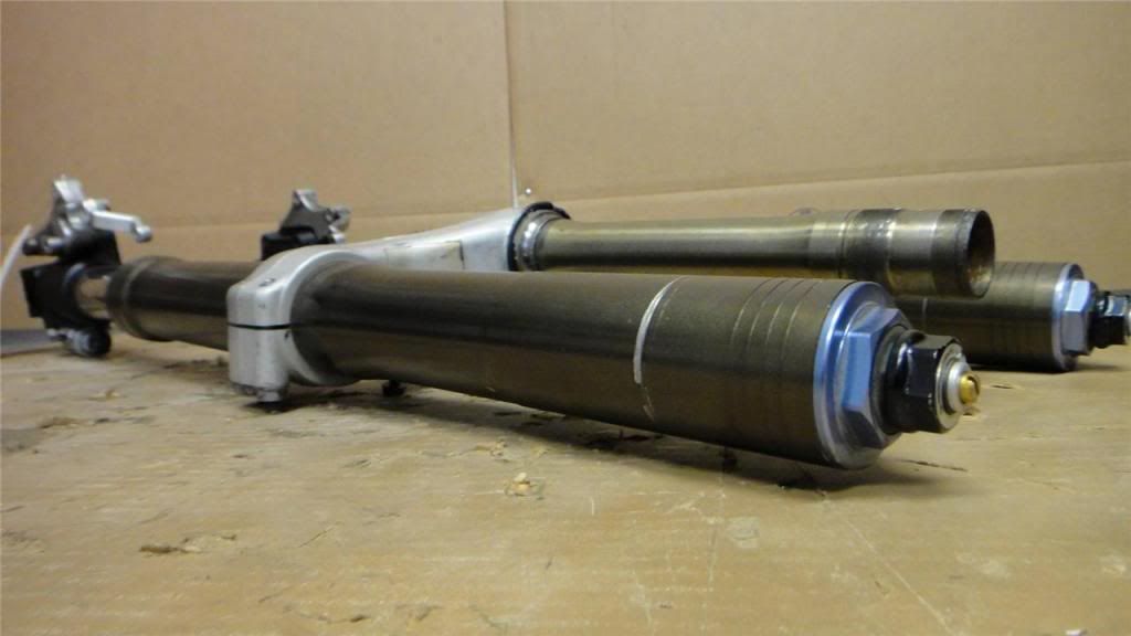

More information on forks:
SP1 forks:
SP2 Forks:
