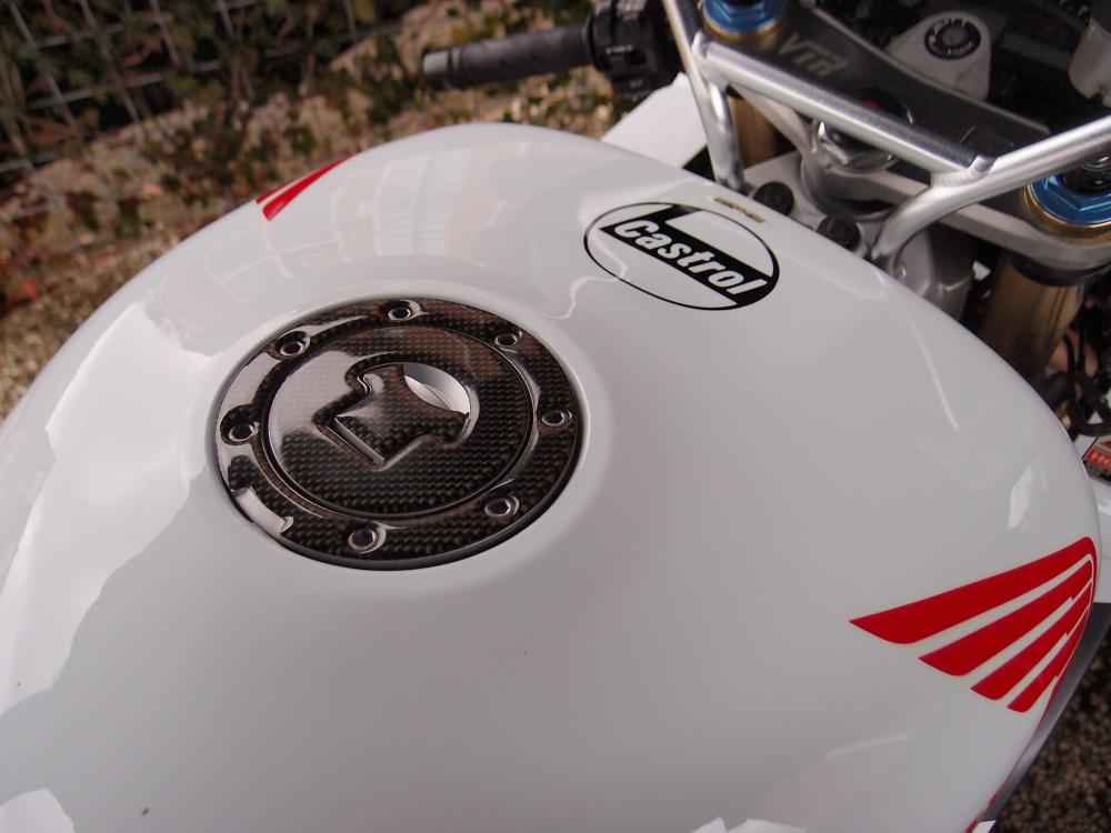

Tomorrow the sun *should* come out. So for now a few pics made under the canopy of a "party tent"

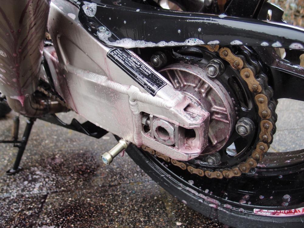

Wash, clay, polish, Collinite 476s

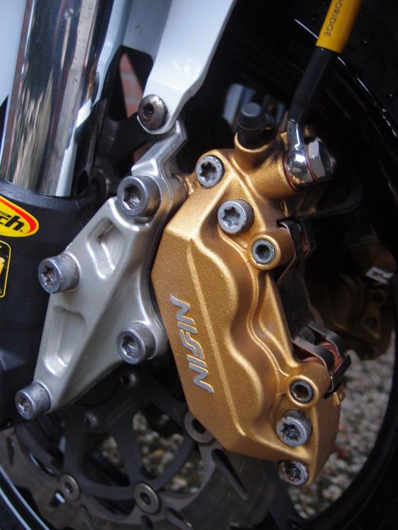

And yes, them bolts need some elbow grease still

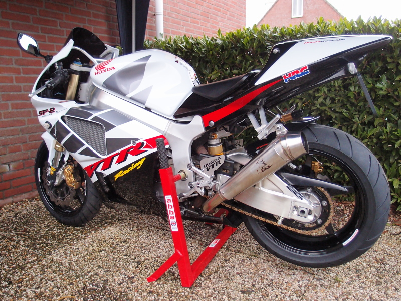

Facing down that little red Ducati.....
No sun today, still a nice SP......

Get some stainless (or titanium if you prefer :grin2:) Probolts with aluminium screw-on collars to replace original fasteners. You can also get replacement caliper pinch bolts from them, engine cover kits, etc. Don't be tempted by alloy bolts, the heads strip off & scratch easily - if you go for those.

Ti it will be, found a source here in NL.
Scouring the microfiches to find the diametres, lengths and pitches for the front forks/calipers.

Use molybdenum disulfide grease to coat the threads of titanium bolts & fasteners, unless using thread locking compound. Stops corrosion of aluminium.
That seat look as if it might not be comfortable for long rides to Germany. :D

The Netherlands being a tiny country, riding TO Germany from my home is <100 clicks... But then it is one big country (for our standards) with still some no speed limit Autobahns out there. And wonderful twisties..
Uncomfortable it may seem, with fuel stops every 180-200 clicks, that will solve itself :)

The (front) bolts simply look grotty, as does the rear chain adjuster.... Dale's kit will rectify the rear I trust.

Borrowing a safety wire pliers this coming weekend for the slider pins and front fork pinch bolts
