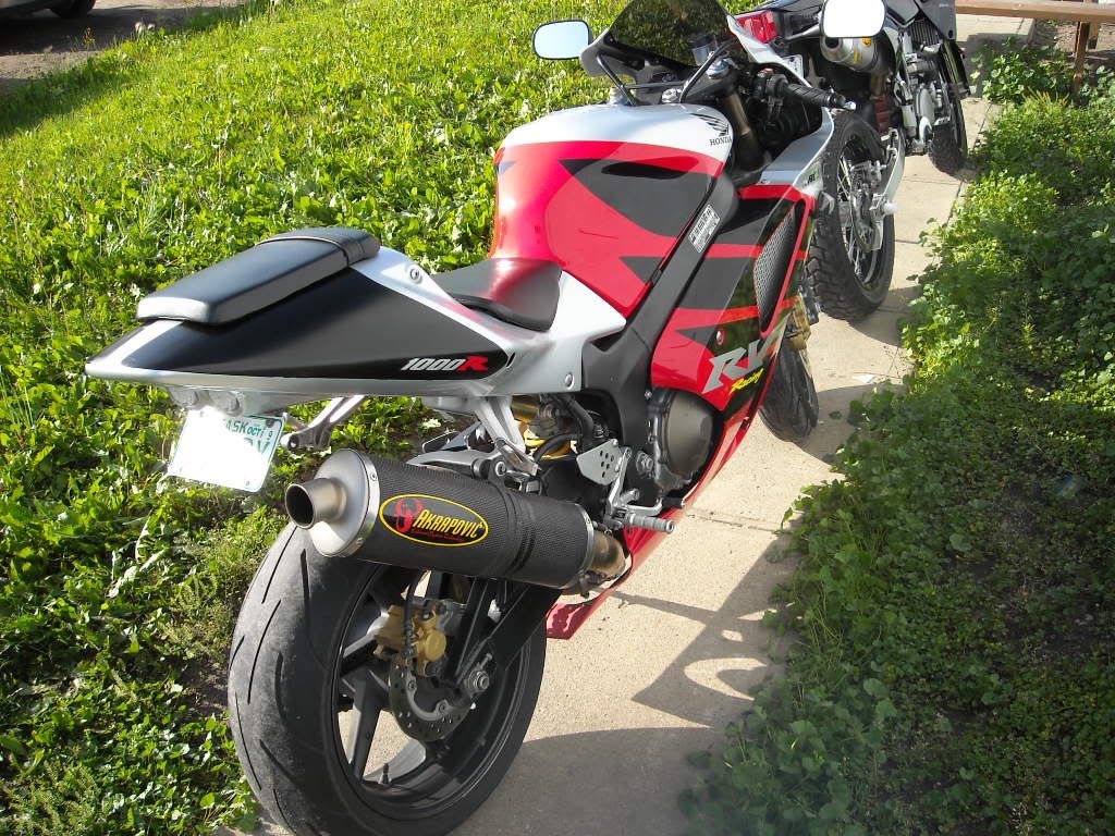

I just picked up a used 01 RC51 in great shape, but guy I bought it from has installed a SP2 Akrapovic on the right side only and the left side is just capped off. I've been around motorcycles for along time, but I've never seen this done before, the bike seems to run fine, and it sounds good too. If you want a 2 into 1 system I would think you would need a full system.
My question is, is this ok? Or should I put the stock pipes back on until I can get a set of pipes, because I want and prefer the dual exhaust look.

I would put the stock exhaust back on!
x2. I can't imagine that not having an adverse effect on exhaust scavenging, correct backpressure, and the pressure waves/pulses from the engine. I'd beware of the possibility of other improperly performed mods on the bike.

Improperly preformed mods had already crossed my mind too, so I went through the bike completely as I would with any bike I own. aside from the exhaust and a fender eliminator kit that's all he did. I believe he was only interested in the looks of the bike and not performance, when I asked him about the pair mod or the flapper valve he had no idea what I was talking about. He's a nice guy and had the dealer do all the service so I'm not to concerned about the bike, he just put that exhaust on a few weeks before I bought it.
As you can tell by my question, I felt this was a improperly preformed mod too.:(
The stock exhaust will be going back on ASAP.

I wouldn't think any damage would have occurred unless he rode it for many hundreds of miles after installation. Even then, I'm pretty sure it would only really affect the drivability. Don't worry, just do what you were planning on anyway. Put the stockers back on and enjoy. I'm betting you'll notice a difference after switching them out.
