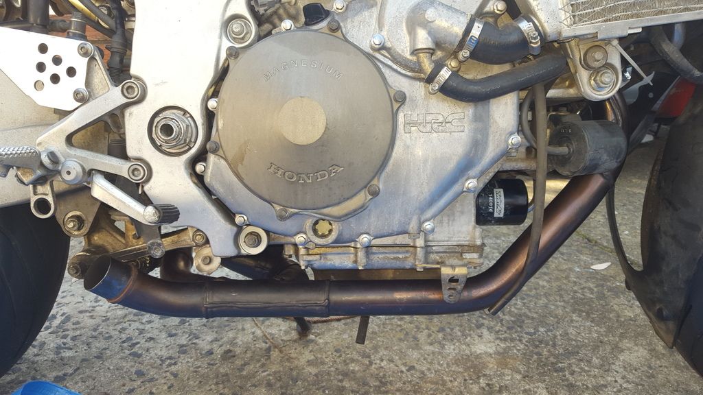

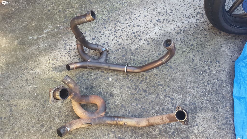

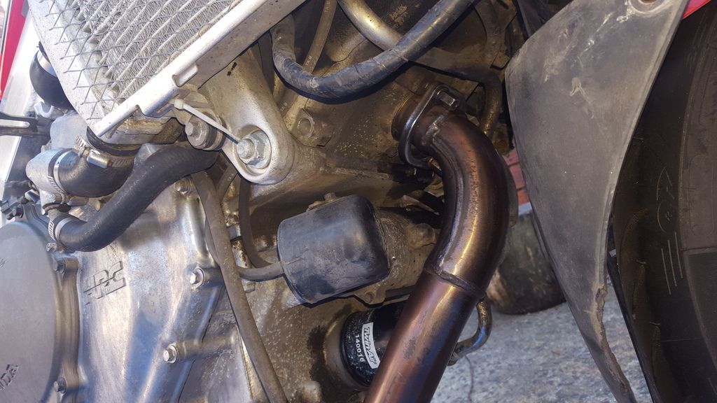

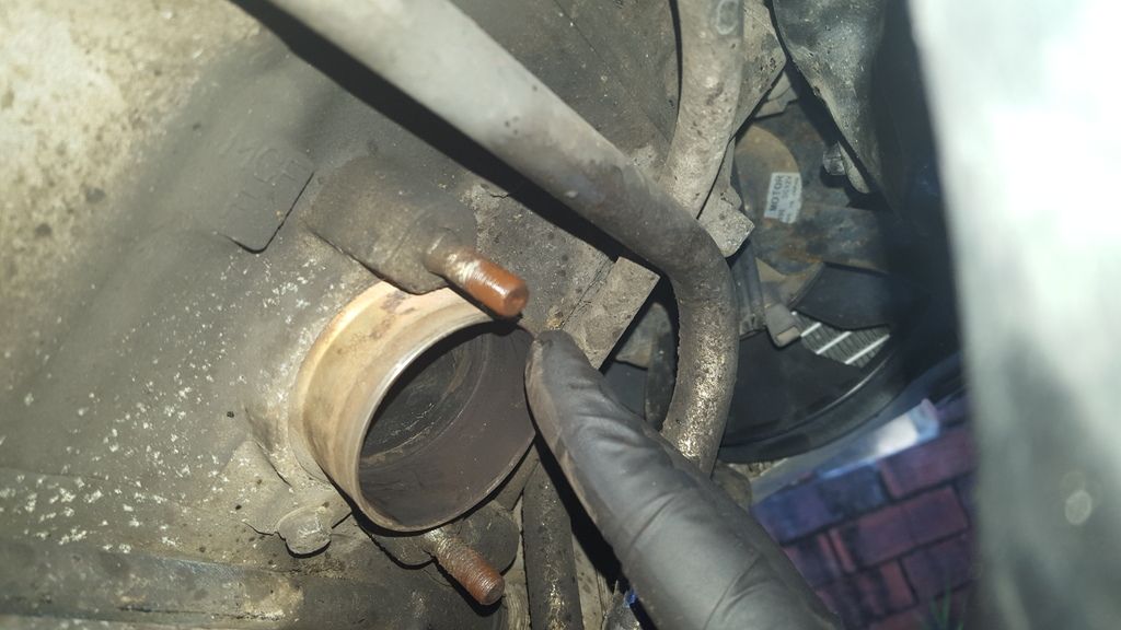

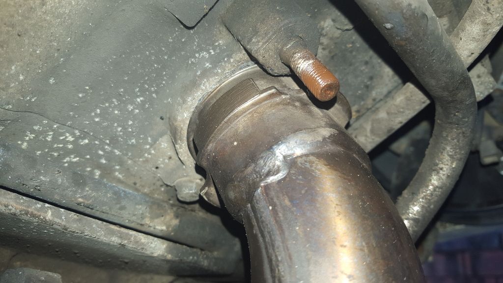

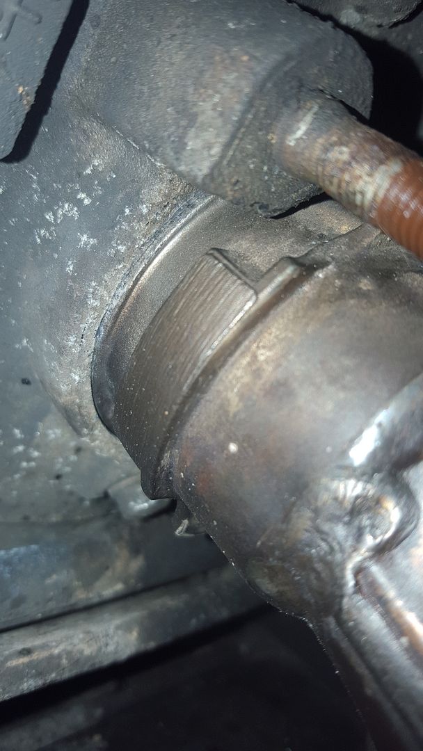

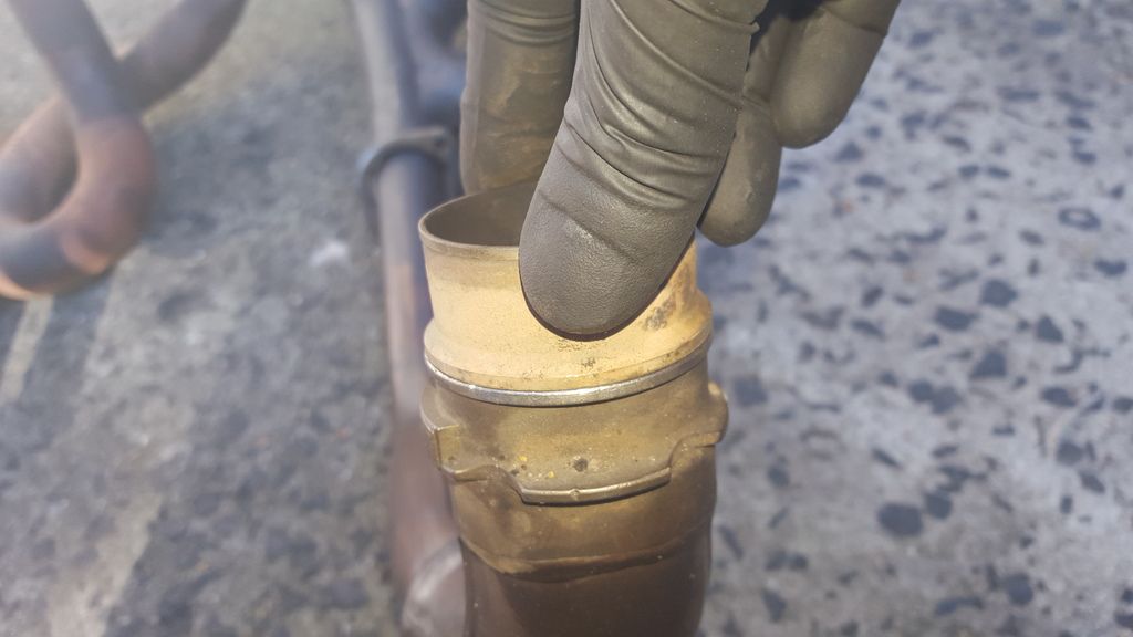

>:)Ok update. I tried to put the SP2 headers on it didn't work properly. I can get them on only if I don't use the gasket that joins the rear header. I tried with the gasket and it doesn't allow enough movement to join up the front and rear exhaust headers.
I measured the SP2 and SP1 headers and the ports look the same size. See attached image.
SP1 exhaust flange fitting onto SP1 engine
SP1 exhaust flange compared to SP2 exhaust flange. They seem to be the same diameter.
SP2 vs possible aftermarket SP1 header
SP2 header on SP1 engine, seems to mate up nice and snug
Rear SP2 exhaust fitting onto SP1 engine, again seems to fit nice and snug.
SP2 header on SP1 rear
Shows the exhaust all put together but missing the rear gasket.
#18 · (Edited)
So i need to figure out a way to match them up with the gasket attached. Currently as it stands the exhaust are all in place and I don't have any clearance issues. The exhaust does touch the belly pan but I reckon if I file it a tad then it wont touch the belly pan.

#35 ·
Quick update. Managed with some elbow grease to move the headers into place. I had to wiggle the rear cylinder link and push it further into the rear header.
I expanded the opening of the link pipe and moved the gasket a bit lower, this then allowed me to push the 2nd cylinder exiting link pipe lower into the header.
Tightened it all up and run it for a few minutes and using hood leak test (soap water) couldn't detect any exhaust leak. I haven't had the chance to run it more than a few minutes as have a lot on and with my schedule will be at least 1 month before I can take it out for a ride to see how it all fairs.
